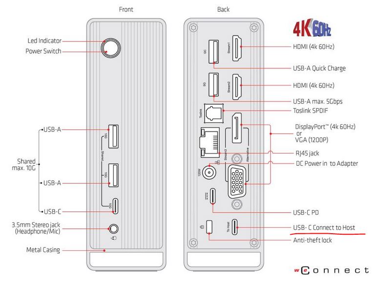

Did you connect the USB-C to the correct port on the dock?
If yes, disconnect the dock, uninstall your USB drivers from the Laptop, reboot the device, let Windows reinstall the USB drivers, reconnect the dock.

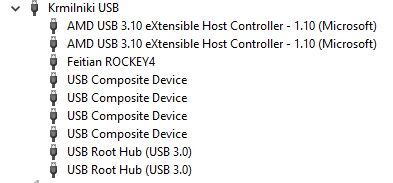

Also could you upload a picture of your device manager? Does it look like this?
Could you confirm that on the power brick the yellow light works? And the ethernet port is blinking when connected?

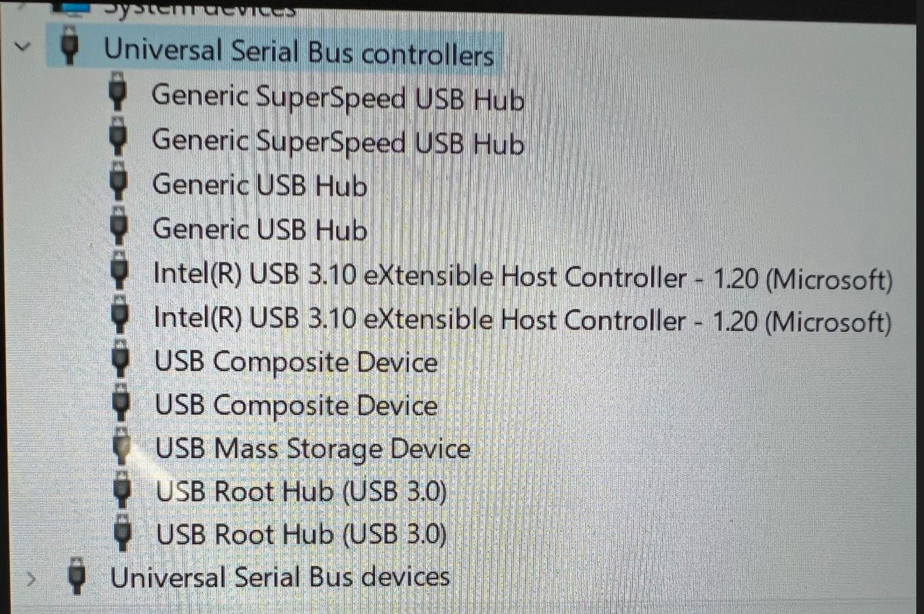

Baak
And how does the device manager look on the X1?

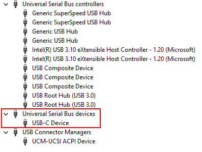

Mike2131
This is the X1 device manager. I circled the present device that is not present on the others and I suspect is the culprit.
0
Baak
The Generic SuperSpeed USB Hub is missing on your L15. Have a read trough the link I posted and try updating the BIOS.
