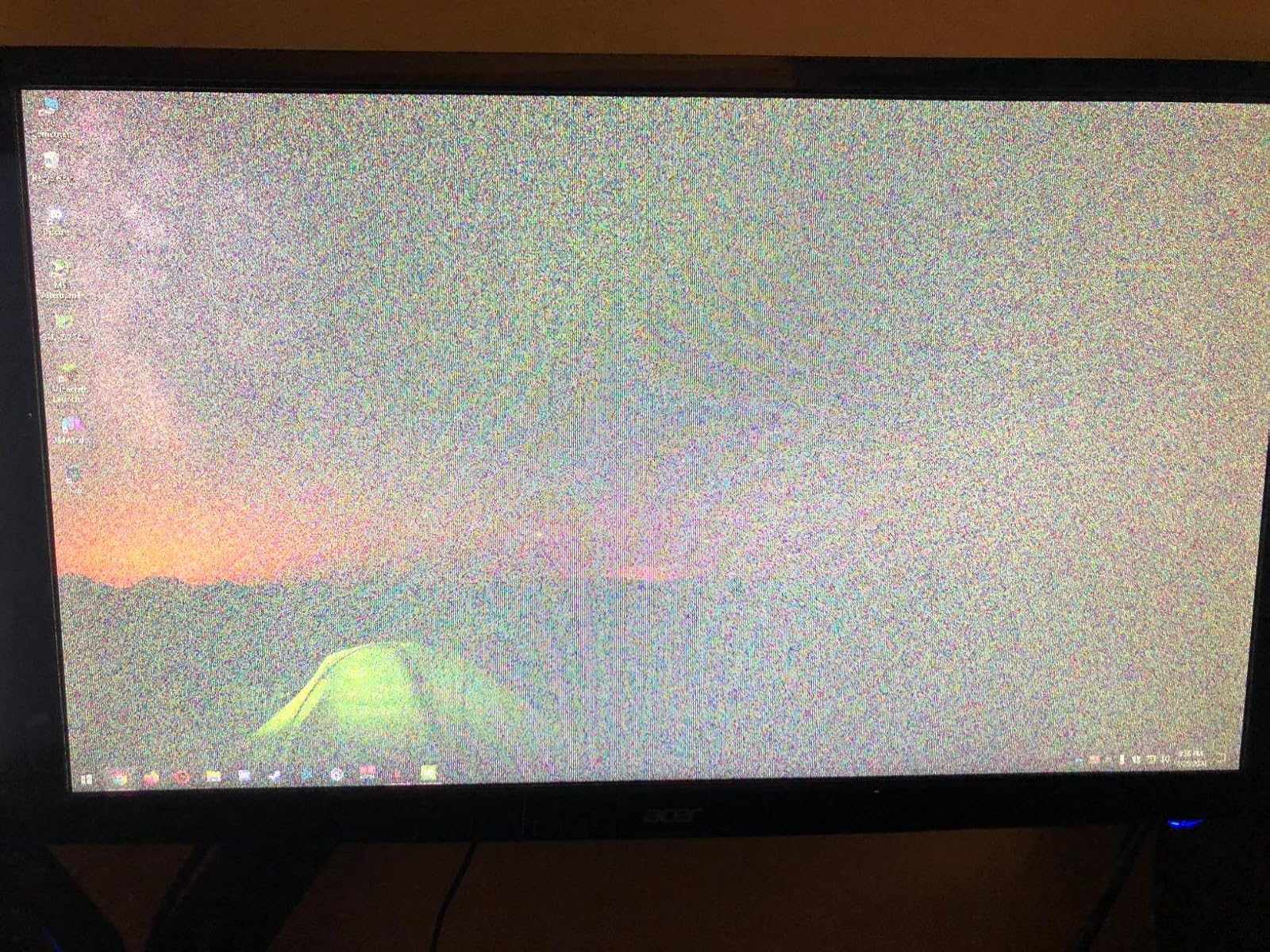

Hi there, I hope you’re doing great !
I’ve bought this adapter to try and help me get my 144hz up for my monitor, Acer GN246HL.
First half day went good, but today it seems I get hit with flickering of up to 0.25s turning black and back, and also the snowy screen happened once too like the following : https://images-na.ssl-images-amazon.com/images/I/91FZ5wqmRNL._SL1600_.jpg
Really like the adapter but trying to look into what I can do to get this properly working.
I9-14900KF,
Windows 11 Pro,
NVidia GeForce RTX 4080 Super,
Acer GN246HL,
Thank you !

0 on 18-11-2024
Hey Santa! 😊
  1. Does this issue occur at all resolutions and refresh rates?
  2. What type of cable are you using?

0 on 18-11-2024
Hey Wiktor, thanks for answering.
I use a DVI Dual link cable from my monitor to the adapter.
My monitor is set at 144 hz.
Resolution is 1920 x 1080, 144Hz.
I _THINK_ it seems to happen only when some content is on screen. Namely I was watching Netflix at some point and was getting these flickers.
Thank you

6 on 20-11-2024
Hi Wiktor and everyone,
Thanks for the suggestoin, the monitor does have a HDMI, and is indeed not used since the purchase of Club3D‘s adapter.
Sadly, this HDMI port from the Acer GN246HL is somewhat of an old version of HDMI, which offers no possibility to get to 144hz. Hence the reason to purchase Club3d‘s adapter.
By the way, it works, but when I show some content it then stops to work, so I’m in no doubt the cable works properly, which is the same cable I’ve been using before and that I can properly test on other computers working at 144hz without the issue of course.
Which leaves the adapter, which seems to have had these kind of issue if I look at other posts where it has been suggested to download some files to try different modes on it.
I’m not going to lie, I thought this is where we were going to go supportwise.
Isnt there tools to diagnostic the adapter ?
Thank you !!
on 21-11-2024
I also have the same active adapter display port to dvi and it has the same issue. Based on the other posts it is an issue with the handshake between the monitor and the adapter for hdcp. I emailed the info email to request the utility for a firmware update to the non-hdcp version as this has been the solution for others but never received a reply. Would you please post a link to the utility to update the firmware to the non-hdcp version.

on 21-11-2024
Hi guys, firmware sent to you both 🙂

on 27-11-2024
Hi Wiktor, so far, I have not seen any flickering, hopefully this will have fixed everything. Thank you.

on 21-11-2024
@Wiktor Thank you for the utility. I have updated the firmware to be non-hdcp and will be testing to see if the issue shows up again. Thanks very much for the help.

0 on 28-11-2024
The update to the non-hdcp seems to have resolved the issue as it hasn’t occurred since the update. Glad it is working for you too!
Thank you for your help Wiktor, appreciate it!
Tom
