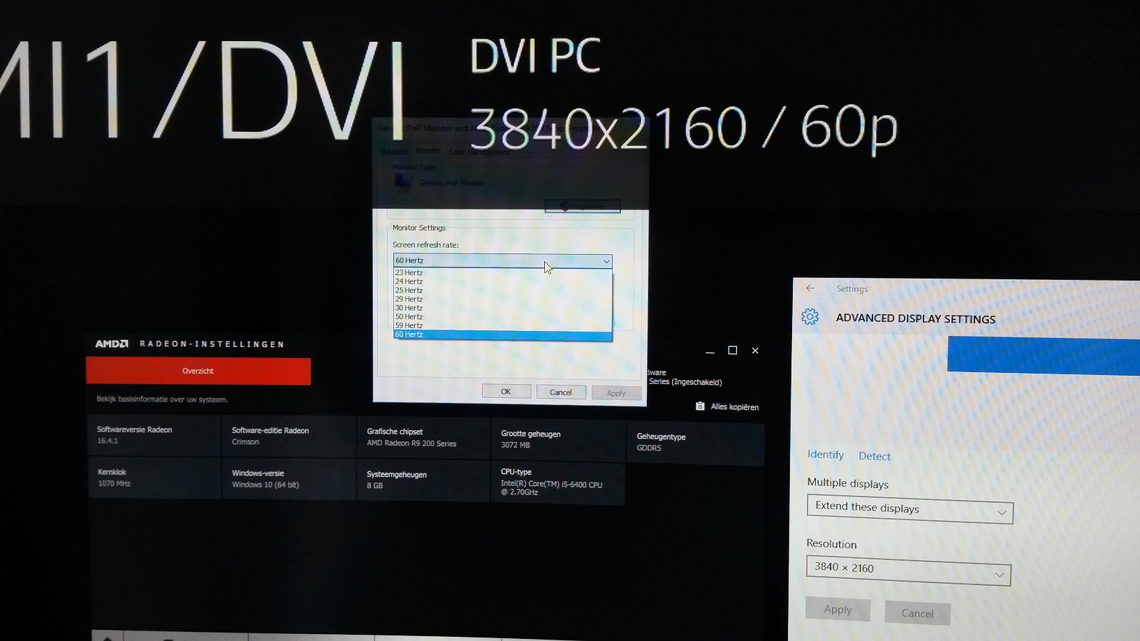

  • Set custom resolution at 3840 X 2160 progressive CVT-reduced blanking

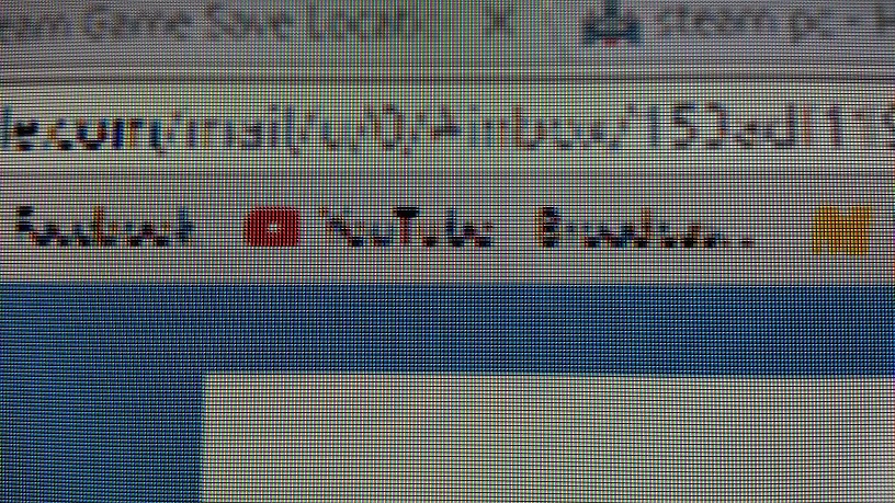

  • This partially resulted in success. I noticed the refreshrate was 60Hz but there was a Haze or pixelarity throughout the screen which resulted in unreadable texts (see picture).
This is the result of custom resolution with reduced blanking. The image size on screen suggests 4k resolution, however the TV reports 1080P @60Hz.
The pixels are sharp so the image is in focus. However, the text is unreadable.

  • Reselected custom resolution 3840x2160 @ 60 Hz in mode DVI PC, Game Mode ON, UHD Color ON, I accepted the hazed image (no revertion) and rebooted in order to see if TV recognized and accepted new forced 4k signal. Failed, after reboot TV saw signal as HD. Hazed image remains
  • Started Advanced display settings in windows, to check status. It reported 3840x2160, @75Hz. Downgraded this to 60Hz, screen then it automatically resized to 640x480 @60Hz (according to TV). Reselecting custom resolution through windows 3840*2160 resulted in non-hazed 30Hz non-fullscreen image.

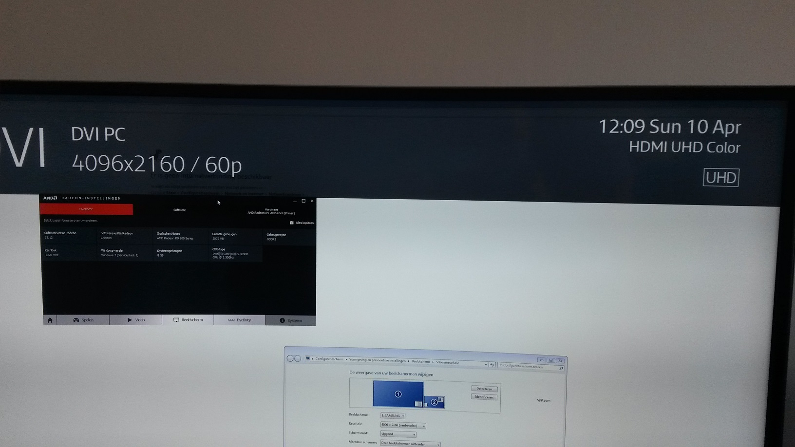

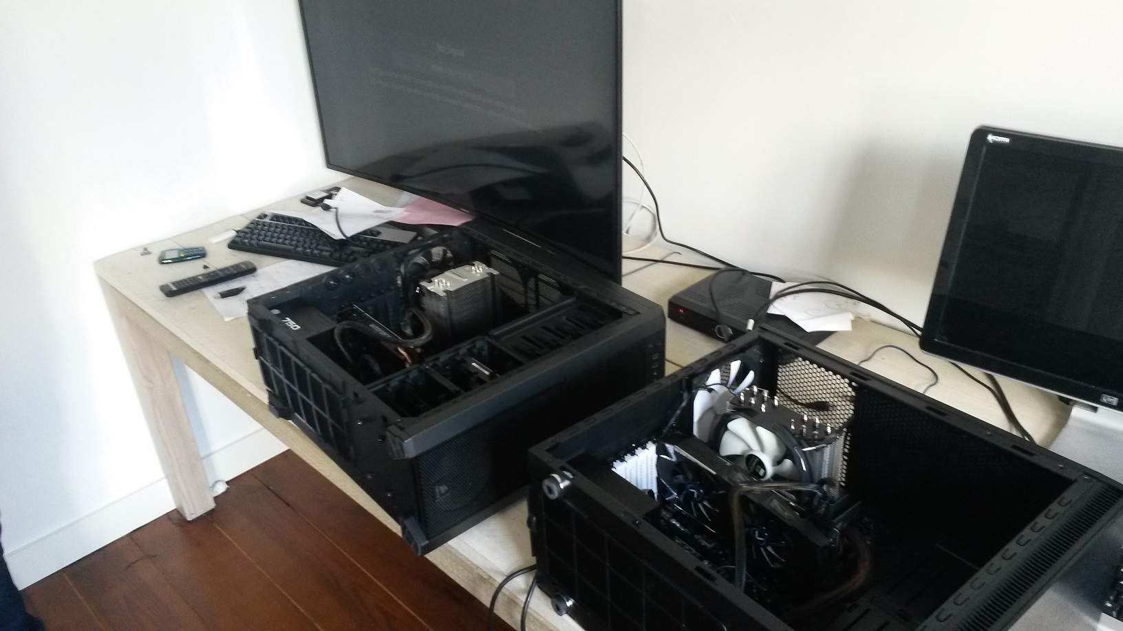

Last week my brother in law came over with his PC (windows 7 x64, 15.11 drivers) which contains a Sapphire R290.
His system, his GPU
When we started his Windows 7 system, the CAC-1070 worked instanteneously at 4k60p:
This picture is his system with 15.11 drivers in Windows 7
To my understanding this rules out the possibility that my Samsung screen is the culprit.
Swap
Next, we decided to swap the videocards:
  • My R390 into his Windows 7 system (15.11 drivers)
  • His R290 into my Windows 10 system (16.4.1 drivers)
Left his system with my AMD R390 Gigabyte GV-R939G1 GAMING-8GD
Right my system with his Sapphire R290
My system, his GPU
We started up my system with the R290 which resulted in success:
This picture is my system with a R290 with 16.4.1 drivers in Windows 10.
To my understanding this rules out the possibility that Windows 10 is the issue in my case.
His system, my GPU
Next we were very curious of course wether or not my R390 would work in his system.
Alas, when we fired up the R390 in my brother in law's system, the video-output was capped at 4K@30Hz.

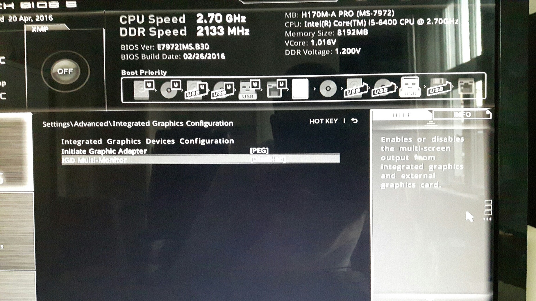

R9 390 in general does not have a problem with support for CAC-1070. Perhaps your particular card. Since it is working correctly for the rest, please check with Gigabyte for a Bios update.
Also be sure to remove all Intel Graphics software (if that is on your system).
Please also check for Bios Update for your mainboard, and check in Bios for CSM (Compatibility Support Module). If your Mainboard has such a setting, please Disable that.

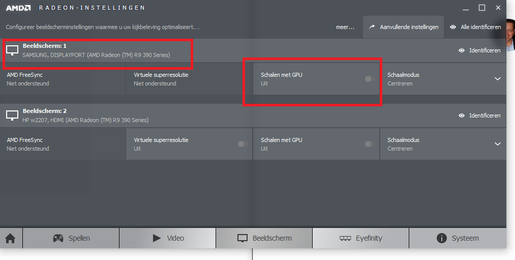

Also Disable GPU Scaling in the Graphcis driver in case that is enabled.

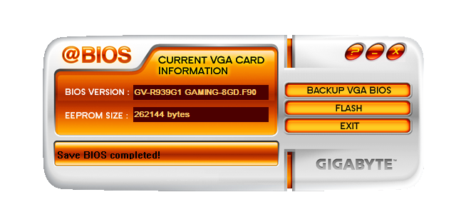

As for the Tips of MST1407, I have done the following:

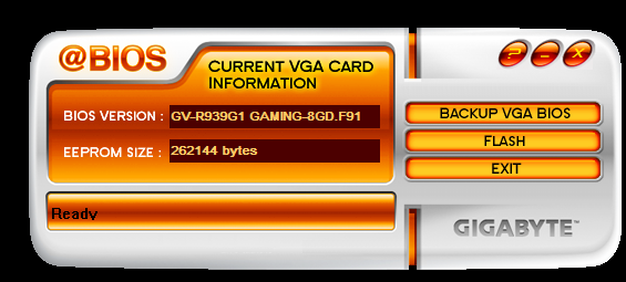

1. Upgrade firmware GPU to newest version (F91):
Source: http://www.gigabyte.com/products/product-page.aspx?pid=5500&dl=1#bios

2. GPU scaling is off

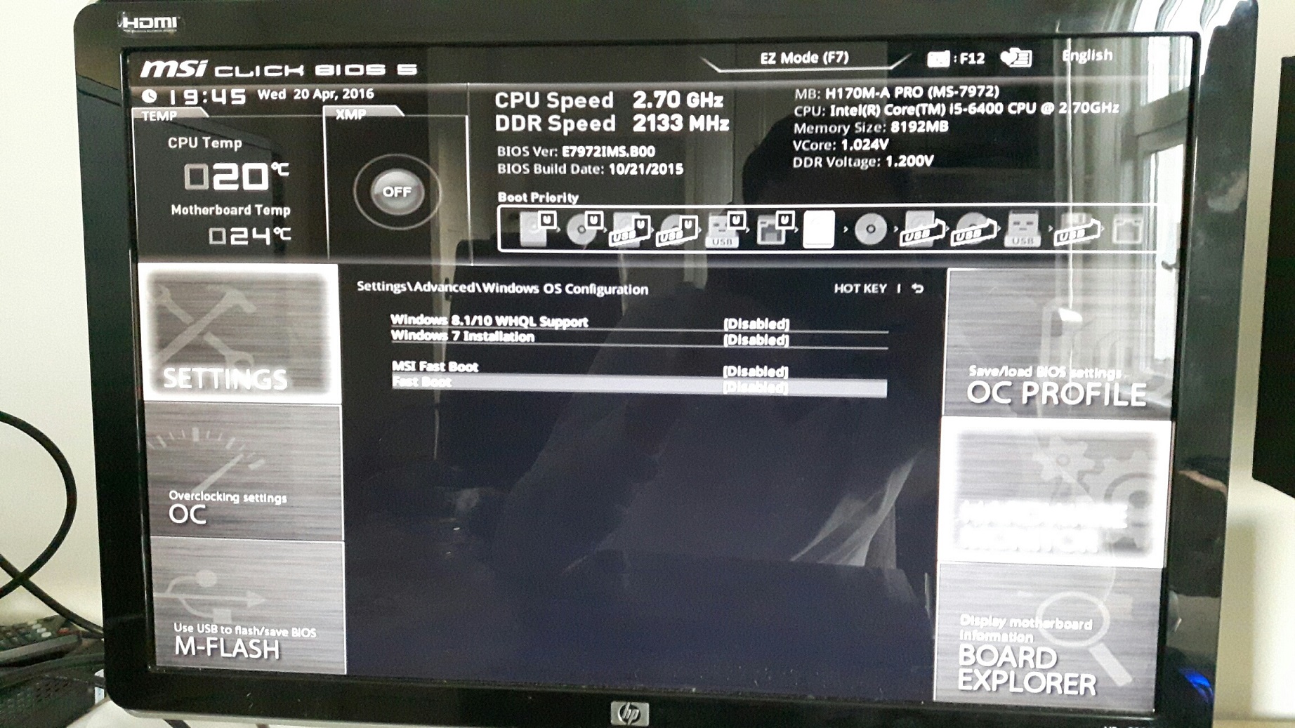

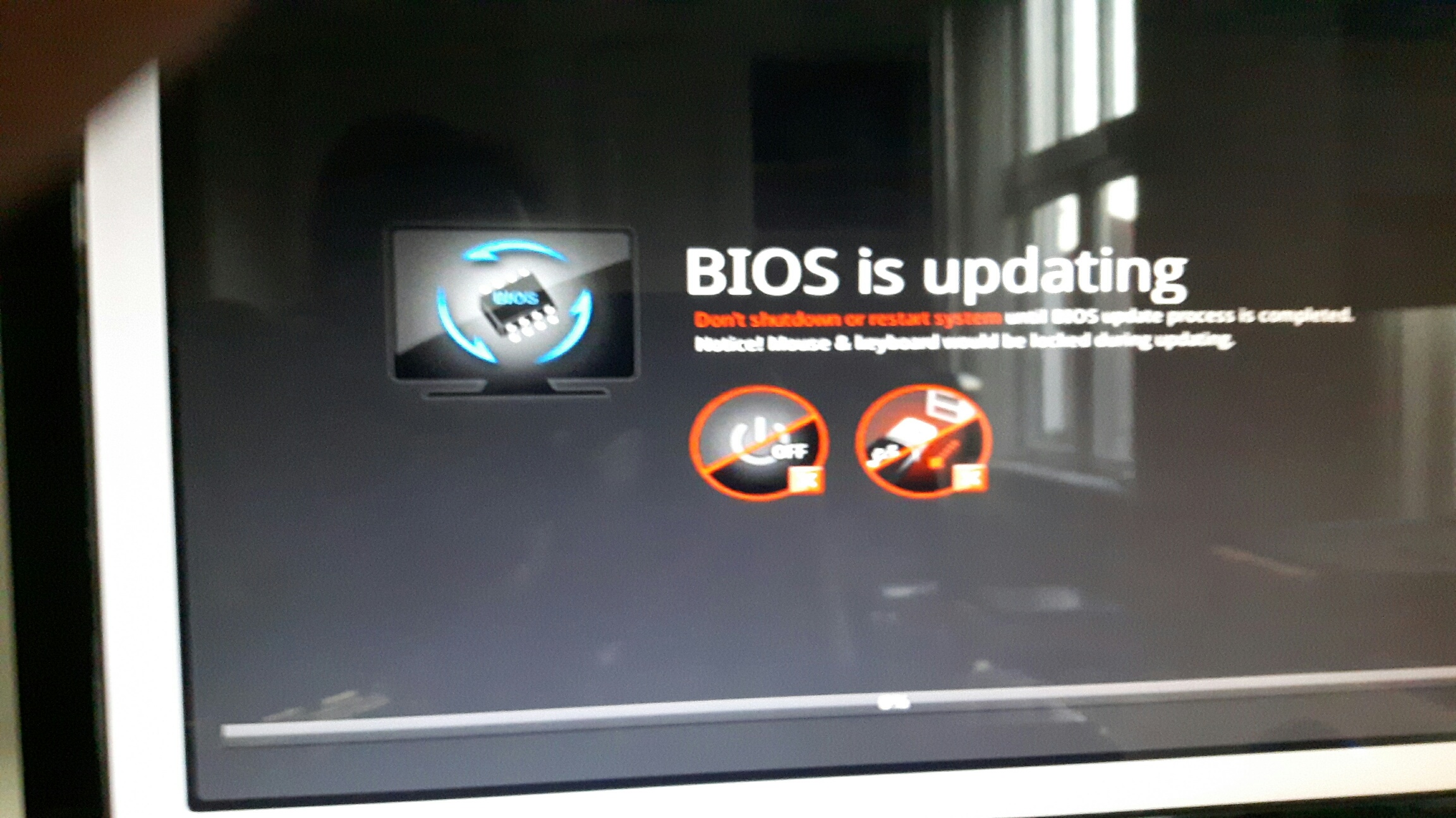

3. Updating Bios
Download from:
<a href="https://www.msi.com/Motherboard/support/H170M-A-PRO.html#support_download">https://www.msi.com/Motherboard/support/H170M-A-PRO.html#support_download version B3
Old Bios:
Flashing
New bios:
Thusfar no solution yet.
Two things still yo try:
1. CSM (I cannot find this within my updated bios, can you advice where it should be located?
2.Remove Intel graphics software
Can you advise on which steps to take here?

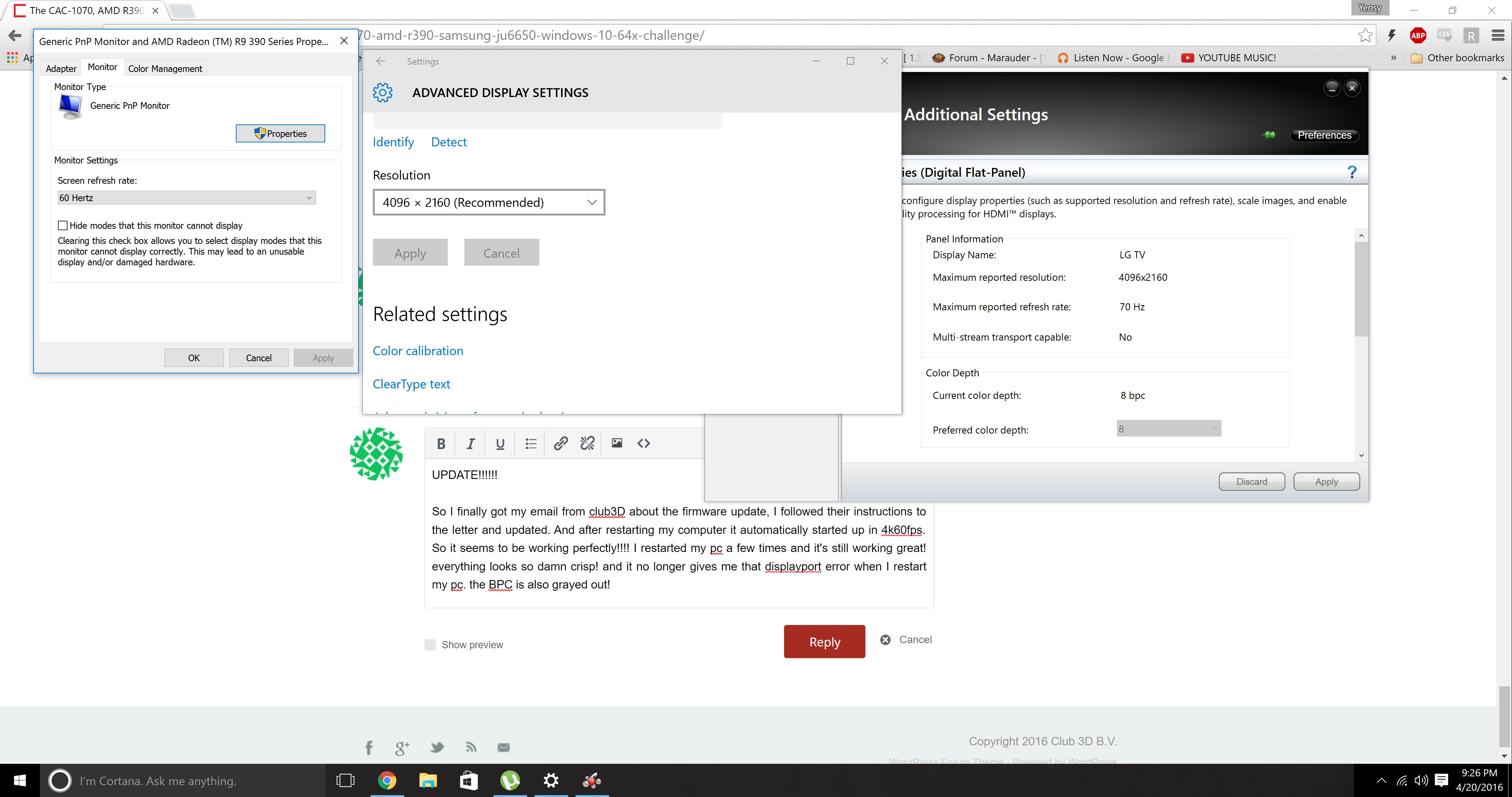

UPDATE!!!!!!
So I finally got my email from club3D about the firmware update, I followed their instructions to the letter and updated. And after restarting my computer it automatically started up in 4k60fps. So it seems to be working perfectly!!!! I restarted my pc a few times and it's still working great! everything looks so damn crisp! and it no longer gives me that displayport error when I restart my pc. the BPC is also grayed out!
Thanks I just hope it doesn't mess up again after a few days.
Can you indicate your version of the firmware? is it 0x07 0x23?
Hi friend,the lately released fw version is 0x07 0x23,
And it's back to 30fps. I also purchased the uptab adapter and it works the same way. So I'm just going to return them and purchase a new GPU when they release in a few months. I'm honestly done trying to deal with this thing.
