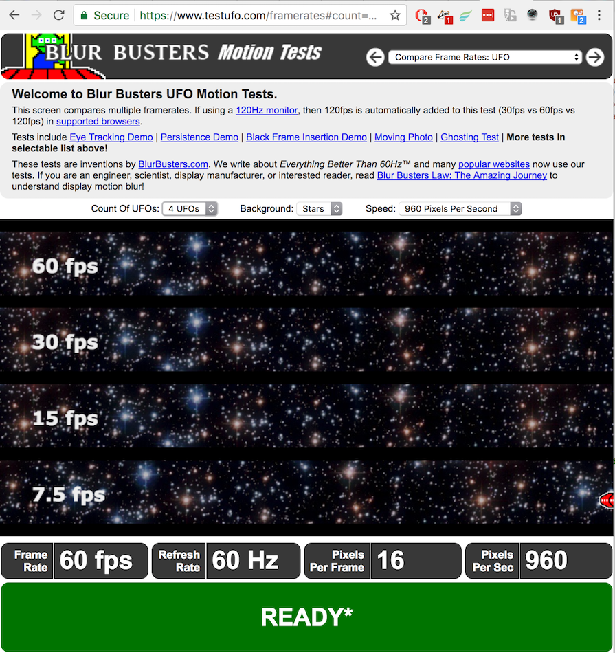

I have tried making custom resolutions with switchresx and somehow I can select 4k@60hz in switchresx buton tv it still shows 30hz on the top bar (tv menu), it even feels like 30hz. The awkward thing is that when I’m doing the hz test (testufo.com) it shows that I have 60hz.
I don’t know what to say … it doesn’t feel like 60hz and my tv still shows that I have 4@30hz.

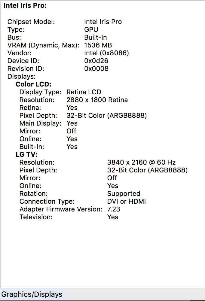

When I select 3840 x 2160, 60 Hz (NTSC) HiDPI or the one without HiDPI the TV works ok, but shows 30hz, even in tv menu it shows 4k@30hz.
In http://www.testufo.com I get 60hz, in About This Mac / System Report… / Graphics/Displays / it shows the resolution : 3840 x 2160 @ 60 Hz.

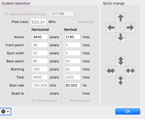

With the help of Club 3d I managed to make it work eventually !!!!
My problem was that switchresx has a bug and stops saving resolutions and I was trying with the ones which were already in switchresx (4k@60hz) BUT they didn’t had CVT-RB on.
I created a new user in OSX and switchresx started to save my custom resolutions.
Now it works with ultra hd on, when ultra hd is off, colours are pink.
My solution was to make sure I use a proper cable (I have tried with 3 cables and it didn’t work, they were all advertised as 2.0 but they weren’t), and make sure you make a custom resolution 4k@60hz with CVT-RB on.
This is a picture with my settings.
Good luck lads !

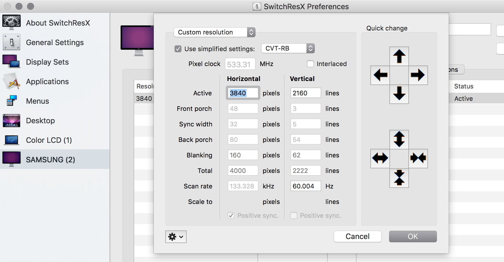

0 on 18-01-2018
For anyone else looking for working settings for:
Computer: Macbook Pro Late 2013 (Retina)
Monitor: Samsung un40mu6300 40″
The following works at full 4k resolution at 60Hz and scales if needed.
