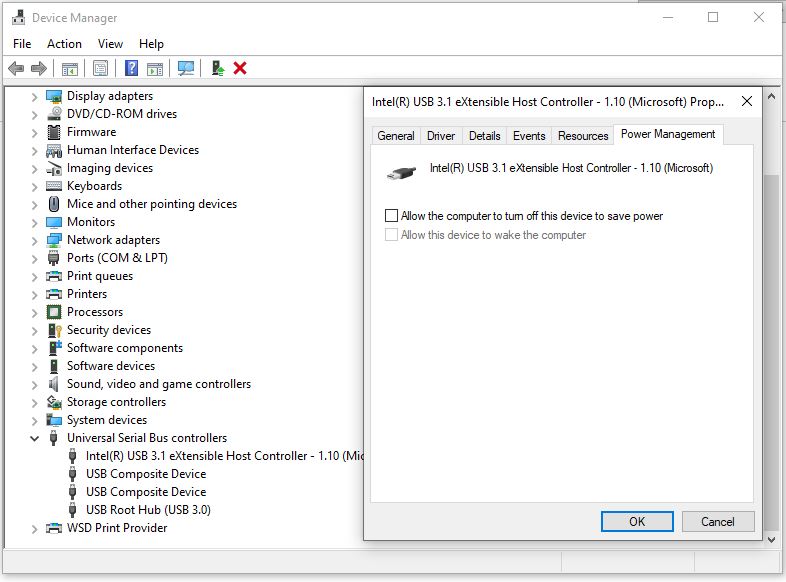

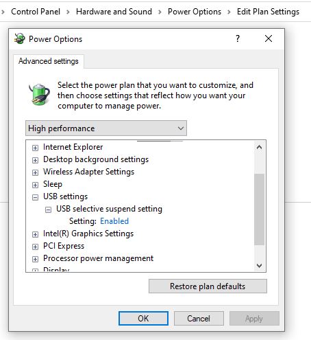

What are the power settings of the USB?
Try to configure what your laptop does after going to sleep.
