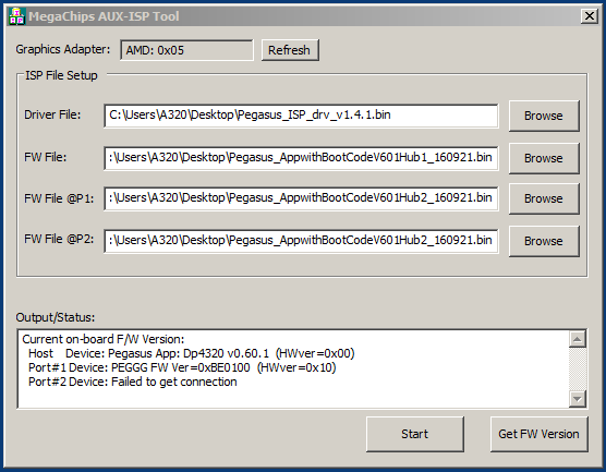

0 0 on 06-05-2017
WSB
Hello,
firmware update seems not to work properly:
After successful ” Refresh” detection of the graphics adapter when I click “Get FW Version” the software tells me “Port#2 Device: Failed to get connection”
What shall I do now?

4 0 on 08-05-2017
WSB
Can someone tell me what to do, please? Firmware update CSV-5300H doesn’t work properly, there’s an error message for Port#2 device: Failed to get connection. I need the MST and want to be sure not to do something wrong. Thank you.
Regards, WSB

0
MST1407
Hi WSB,
I will have that firmware and updater program checked out here to see if we can duplicate and find out what wrong.
How many screens did you connect while updating and to which ouput ?
If only 1 screens please conenct to the middle output on the Hub.

0
WSB
Hello,
as expected no success with connecting three identical HDMI 1.4 displays to all output ports… the error message still exists. So two possibilities: firmware update does not work properly or device is out of order = hardware error. Second possibility would explain not to get more than one TV running. I need my CSV-5300H for work so urgent help is needed.
Regards, WSB
0
MST1407
We finished testing here ourselves.
We did also get an error on the second Port “failed to connect” and also during update procedure it gave an error at the end that it has not been able to update the second port.
What is even stranger is that it does work well. We got picture on all 3 screens in 1080p 60Hz without even have to do any display settings.
I will send issue to R&D to check on what going on with that updater program, so that can be fixed.
Meanwhile if you connect 2 screens you are not using the second port (is the 3rd HDMI output) so i don’t think that this is where the problem comes from.
Please try this.
Connect MST Hub to Graphics Card with Mini-Dp to DP Adapter that came with the MST Hub.
Connect first TV and turn on. Boot system and set the screen to 1080p 60Hz in windows display settings.
Only after this is working connect second TV and turn it on. Press the reset button on the back of the HUB, it will now build up new video connection.
After the TV’s have recognized the incoming signal from HDMI, Windows should now see also the second TV, set it to 1080p 60 Hz in
